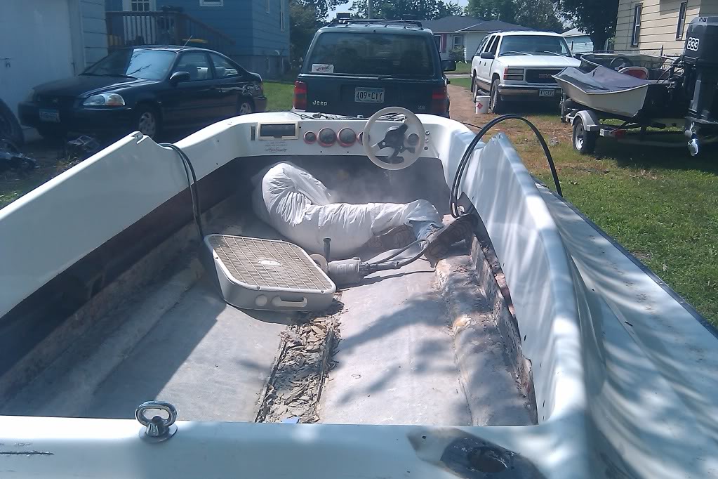

Yea its pretty bad rotten. Its even worse towards the front. I wouldn't have thought that was bad but it is. brushed out like dirt.

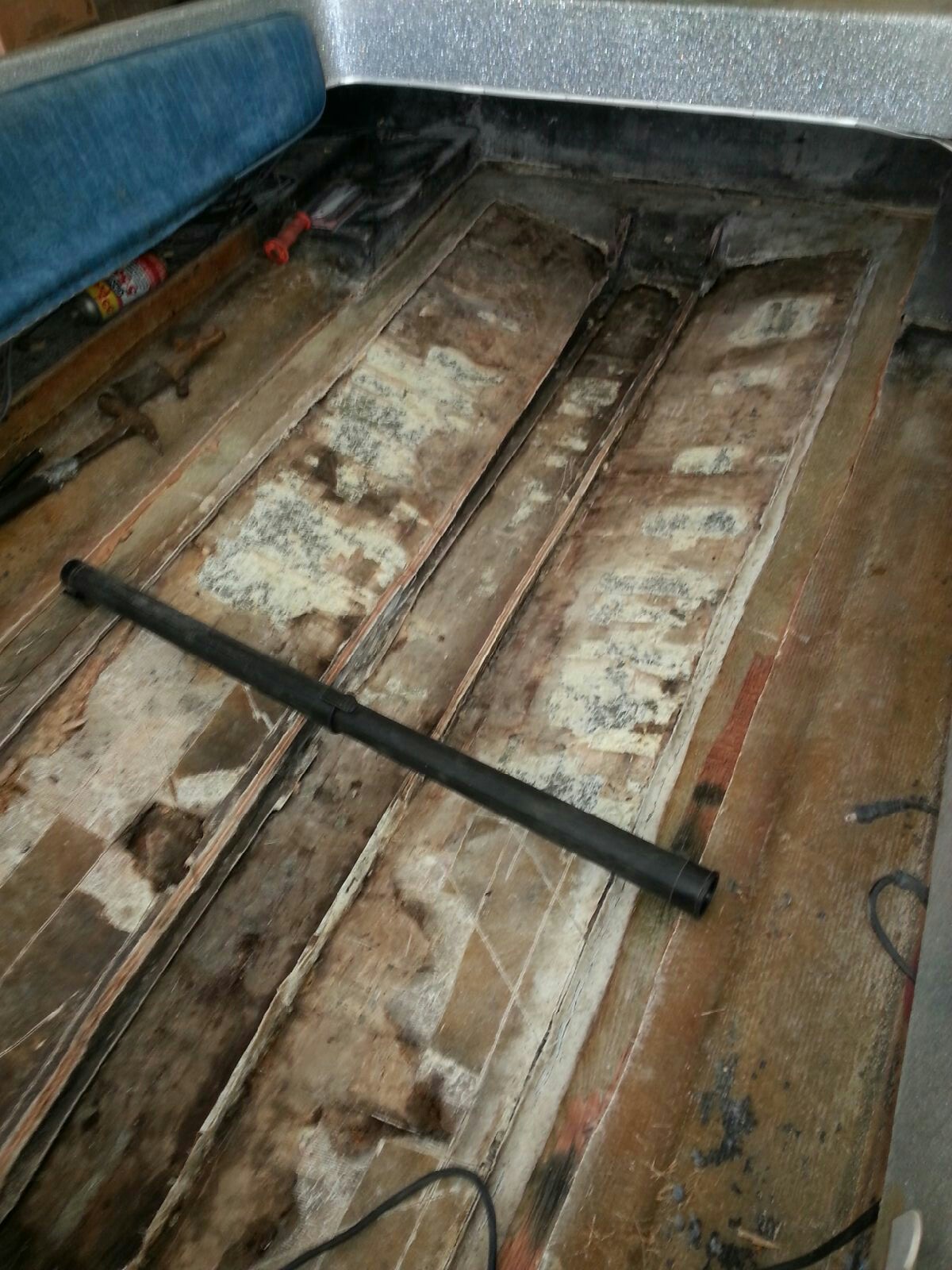

Got a lot of core out today.
All the white spots the core was still very strong. [ Post made via Android ]
