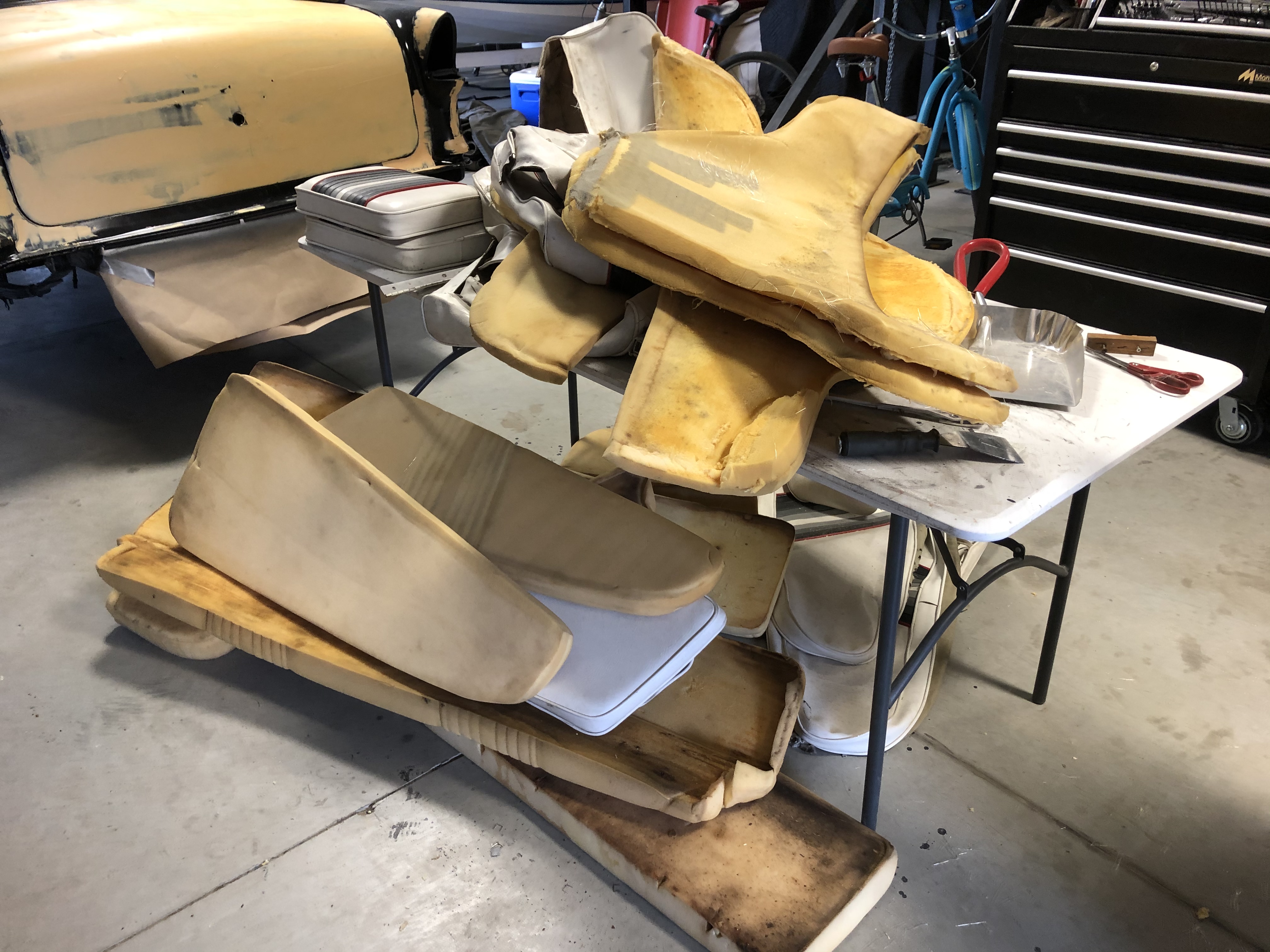

21 hr run each way over to get it. Kid was trying to be honest. gel cracks all over rear deck and back of sponsons. ( black) not a good gel color. Gets too hot and cracks.
The upholstery was soft except for the small holes and the lower edge where it was hard and brittle. Oh and the plywood frames were either broken or rotten... the fiberglass bucket seat shells had busted arm rests so they were reglassed..
Yea,... not as advertised... oh well, what do you expect for $4000?

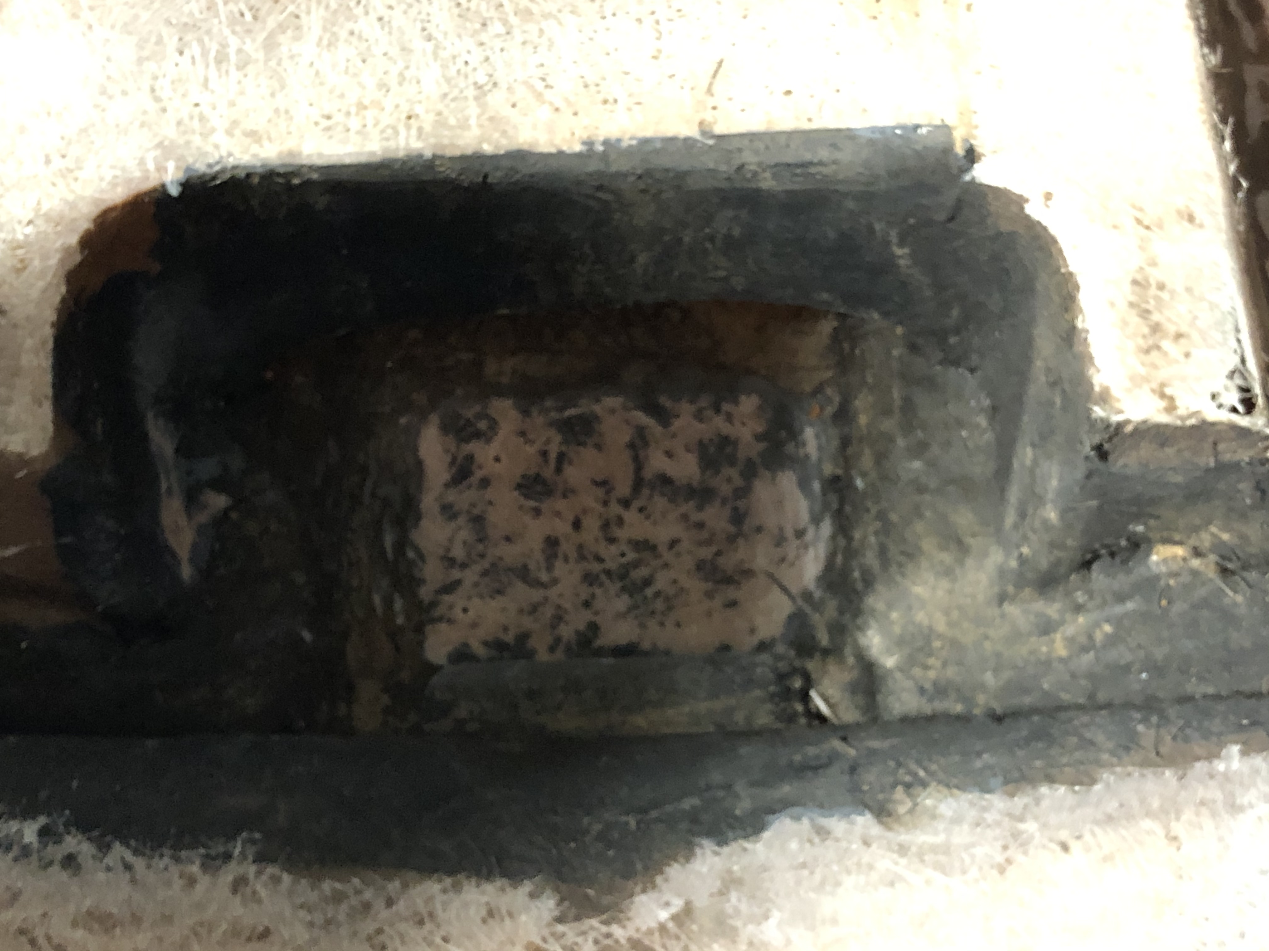

Got it home and pulled the rotten floor out. Was surprised to find golden core everywhere!!!
No spared resin on this layup..

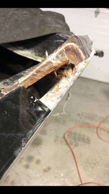

The stern eyes were sucked in the transom so it was removed. The plywood was still golden but was wet!!!.
I found a great deal on a 300 ProMax so that’s what’s going on the back. Adding another layer of plywood to the layup.

Pulled the bilge pump base and ground off black gel and golden core!!! I’ll glass over this area and glue the base down..

The original transom used three layers of 1/2” plywood with mat between each layer.
Since I will keep the splashwell for rigging hose clearance when fully tilted up, I will add a 4th layer of 1/2” plywood. The last layer ( furthest forward) will have the veneer grain running vertical.

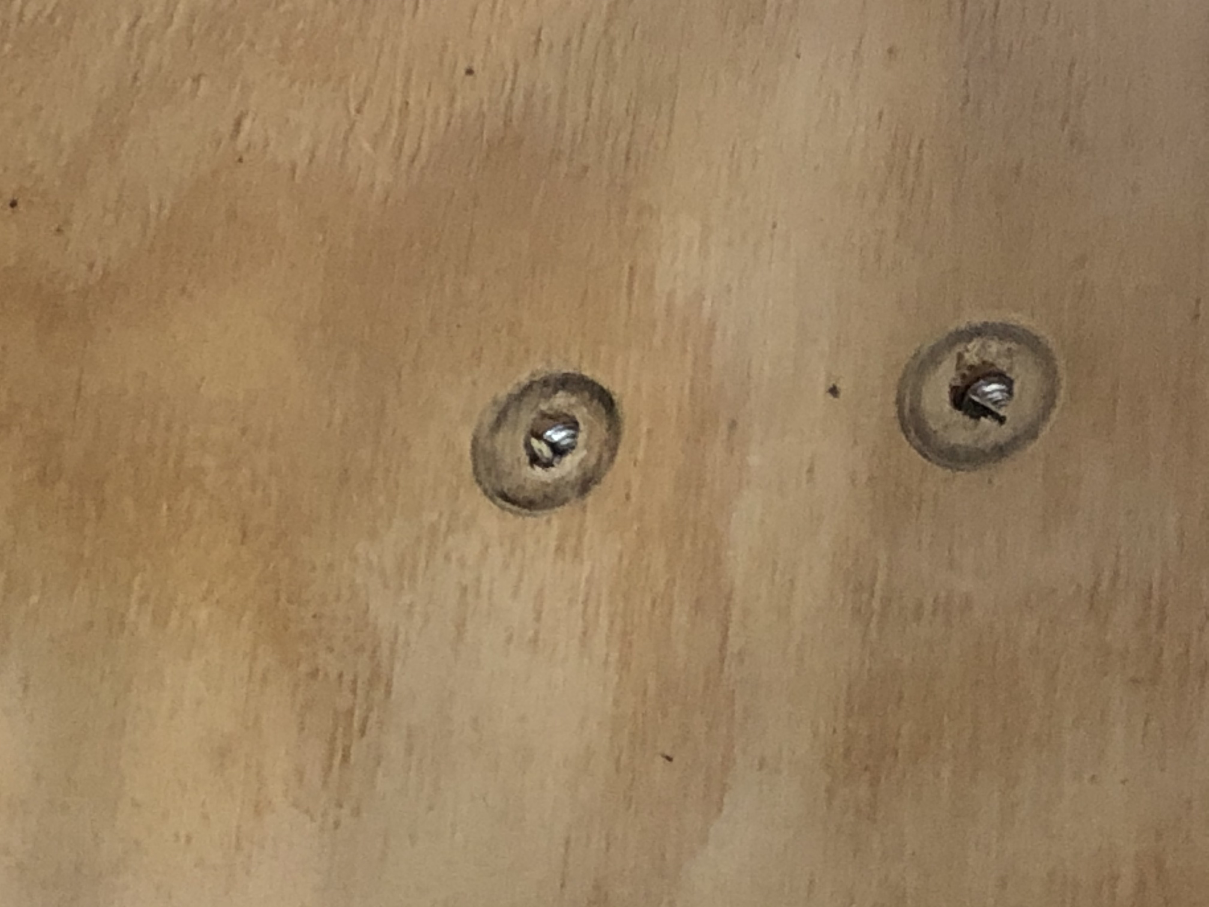

I’ll pre- fit the gas tank & battery box and put stainless T- nuts under the floor for secure fastening.

John Tiger said the later models got more resin due to come backs.
This one is definitely chopper gun built.
The top of the transom and inside of splashwell are around 5/8”-3/4” thick!!

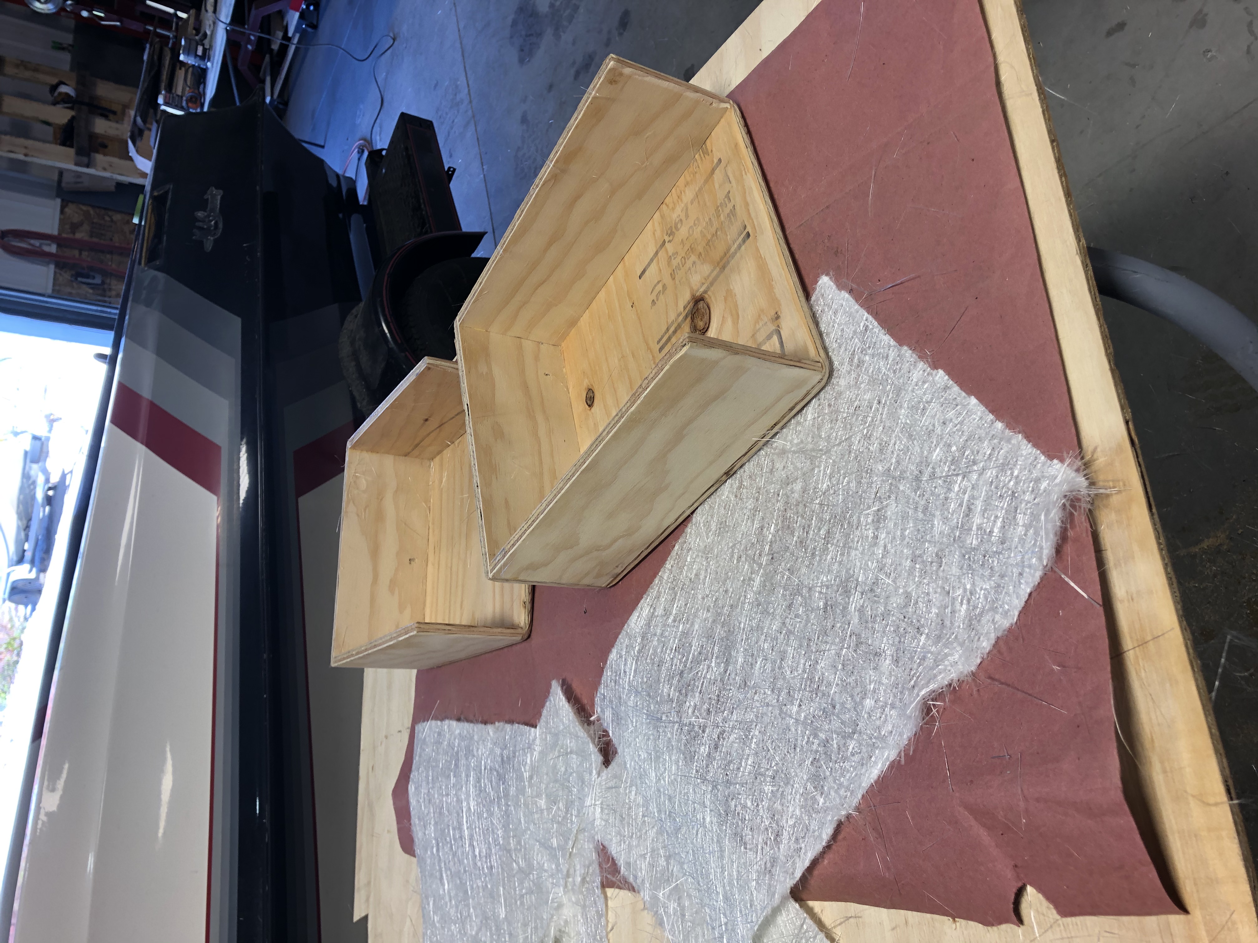

Last couple days I got the transom laid up, floor down and glassed in, new seat boxes made and glassed the inside of the boxes. I refit the gas tank and put T-nuts under the floor .
