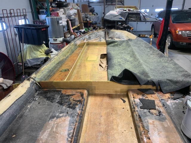

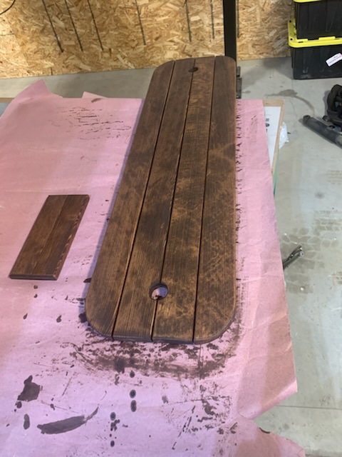

Just because I don’t have any resin doesn’t mean there’s nothing to do.
The ski locker hatch looked like it was made from pallet wood and sheet rock screws.
I went to Home Depot and got two 8’ sticks of Mahogany 1x4 and made a new one.
There was just enough scrap to make the glove box door.
A new tongue jack and wiring kit were put on the trailer.
I mixed up some pour foam and filled the forward sponson cavities.

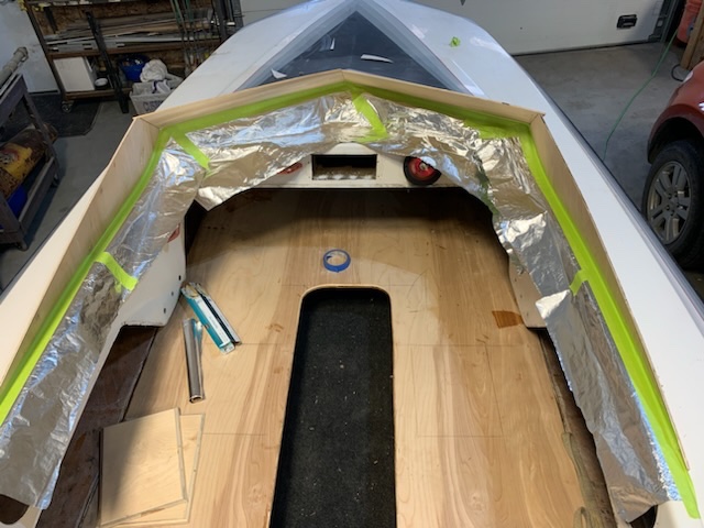

I put the deck on so it would be easier to roll outside for the gelcoat grinding.
While waiting for the temperature to rise tomorrow, I decided to make a mold for the windscreen.
I’m running the sides a little further back as it seems to look better with the long lines in the deck shape.
Hot glued paneling and two coats of Johnson paste floor wax. The mounting flanges will be on the inside.
Also straightened the bow rail .
It was really outta wack!!!

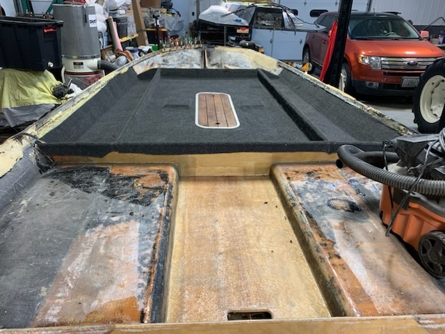

Today I put in the carpet. One piece 8-1/2’ x 9’.
I fit the gas tank and realized there’s no way you would get a bilge pump in the floor opening. There isn’t enough height.
I may drill a hole in front of the tank , thru the floor and put one there. There is bilge wiring already run and I have a bilge pump sitting in a box.
