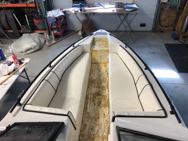

Last couple days were spent on the front contour seat cushions. Piping on three sides and French seam on the fourth.

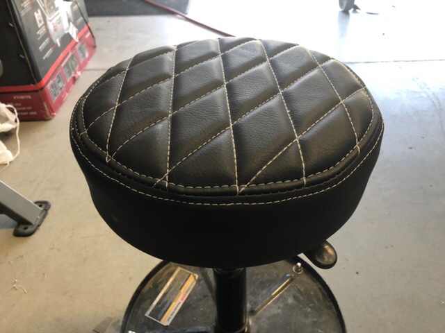

My Harbor Freight stool was not comfortable while sewing so since I wanted to try diamond pattern ,.... here it is.
Took about an hour . Drew out the pattern with chalk pencil, spray glued it to some 1/2” sew foam and went to town.

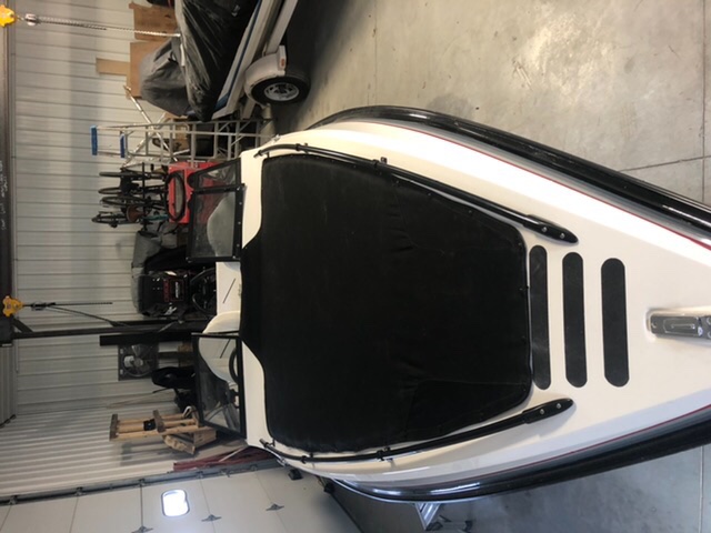

Had some down time so I’m making a bow cover.
Same procedure as the seats, plastic for pattern, transfer to black sunbrella fabric, add 3-1/2” outside your finished edge, fold edge over twice, staple to hold and stitch. Add a binding around edge for that ultra finished look.

I got the bow cover is stitched and fitted.
Cockpit cover is coming up next.

Today I got the rear seat back installed and the rear seat mounted.
Foot throttle adjusted and mounted, edge trim along....um,... the edge ( duh).
Passenger seat slider is due tomorrow so should be good for the weekend.
I got the bunks covered and re-attached yesterday.
