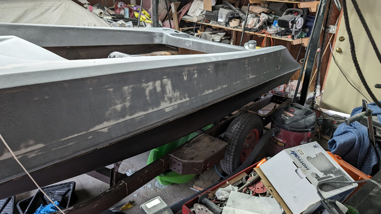

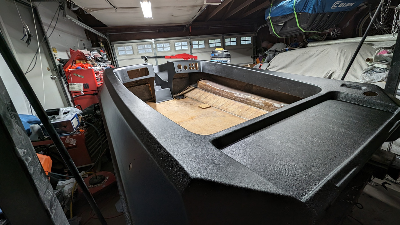

Primer has been all put down, and is now being blocked out. Turns out this hull is very wavy, so Im going to have to put down another coat on the topside when I am done blocking it all. But the surface is going to be like glass when its done.

Re: 1980 Hydrostream Vamp restoration

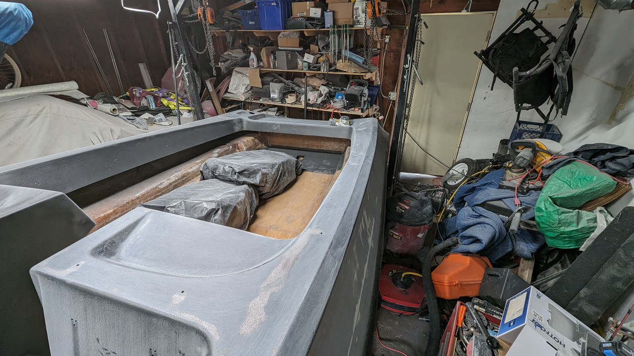

Another round of primer and more sanding. She is looking better now with no real waves in the hull. Going to block out the bottom today and monday and then I need to clean the garage so I can gelcoat it.

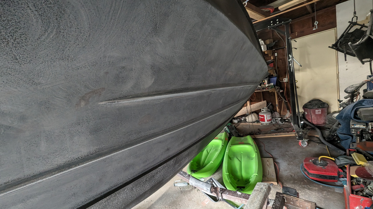

Block sanding the bottom now to get that nice and smooth before gelcoat. Ive got one side done, working on the other side right now then I will tackle the keel to get it nice and smooth.

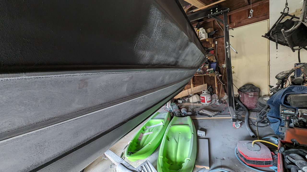

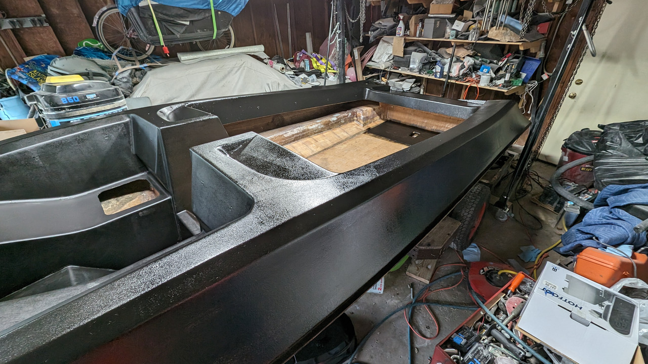

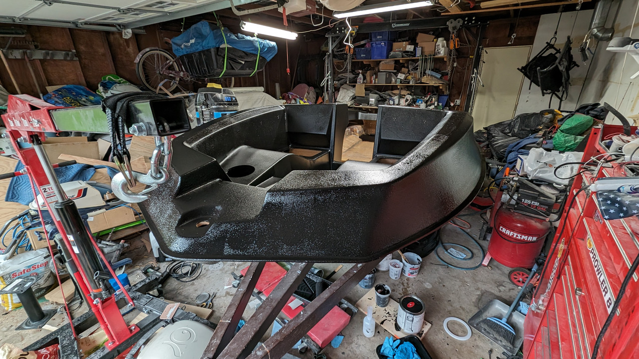

Bottom of the boat has been sprayed with black gelcoat. I did 5 layers and a layer of PVA over the top of it. Going to let it sit for a few more hours and then put everything back into the garage for the night.
Hoping to get to spraying the top this week or next Saturday. Going to make sure I have lots of time to do the topside since I will be using glitter that I dont want to mess up.

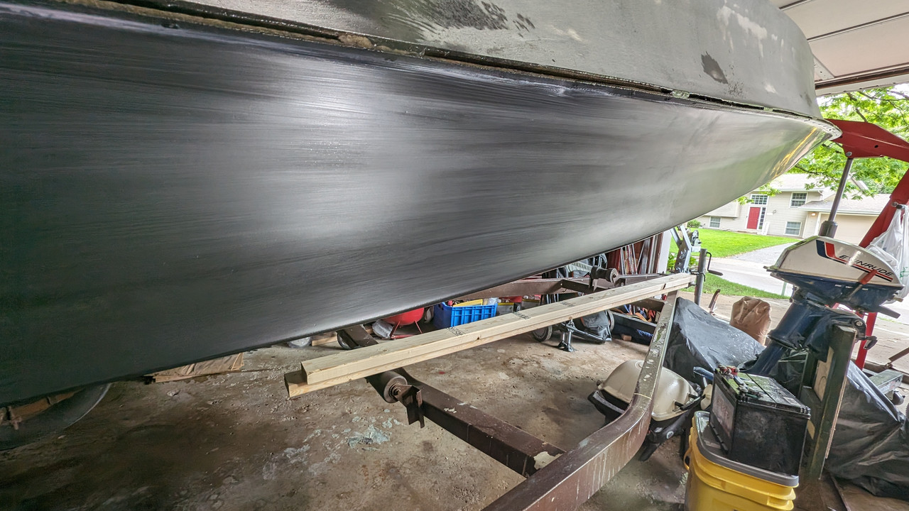

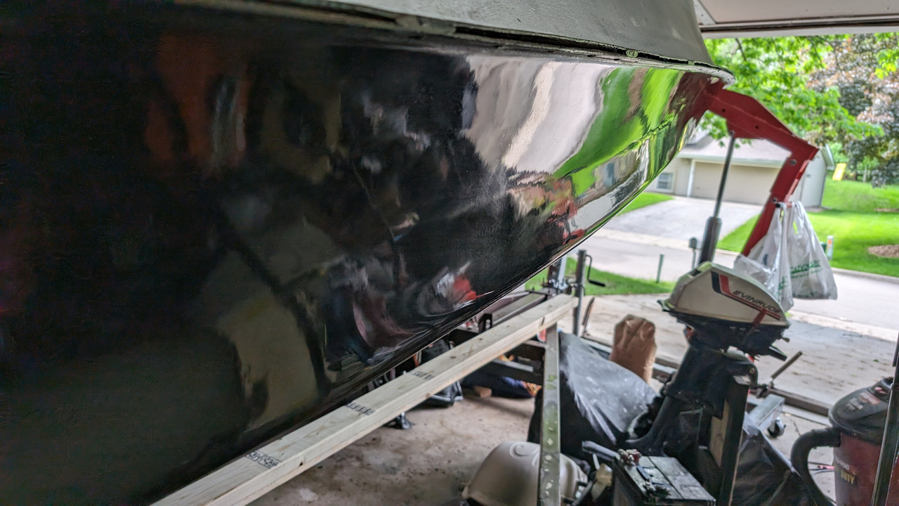

Started wet sanding and buffing the bottom while I wait till the weekend when I can spray the topside of the boat. Not perfect, but overall I think it came out pretty good. I think I am just going to wet sand down to the middle lifting rib. This is a good compromise between going insane with sanding, and the boat having a nice shine when in the water.
