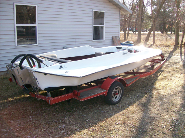

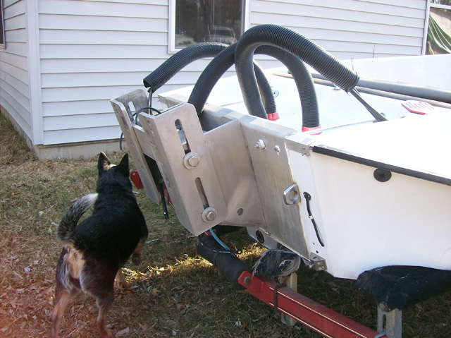

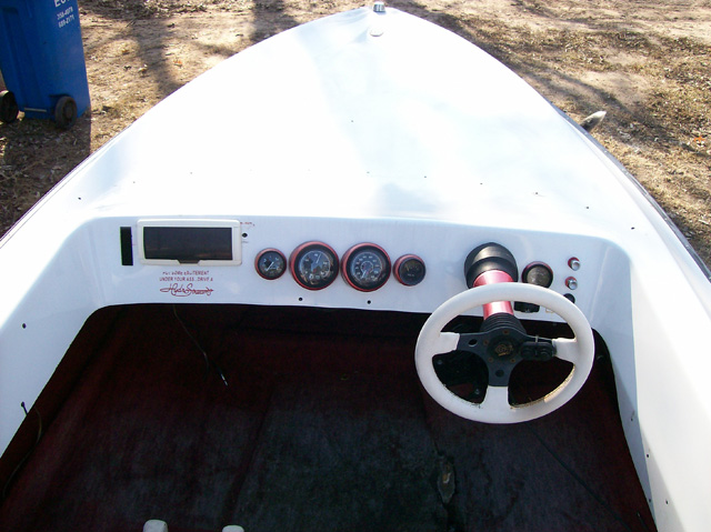

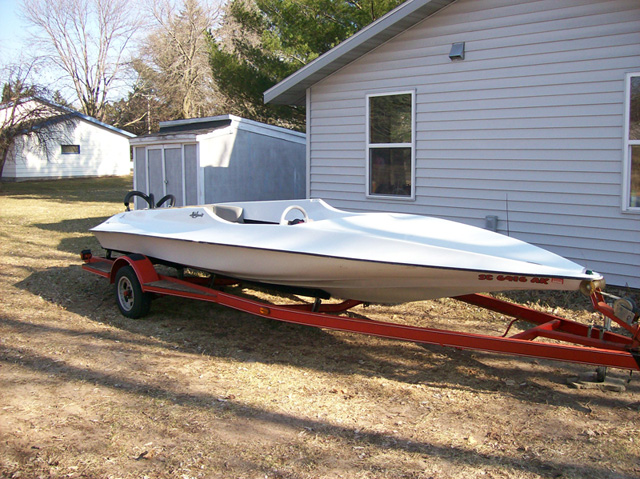

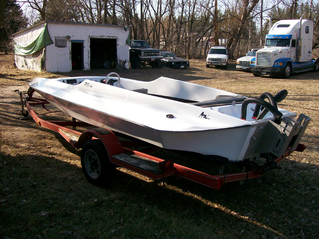

Well, I made it home with my new Vulture but it wasnt easy. About 1/4 of the way home the transmission on my truck decided to go south and lost overdrive and about 3/4 of 3rd gear. After a quick temparay fix (Gotta love Lucas products) I was back on the road. It was a slow drive home but I made it.
Here are a few pictures of my new 1977 Hydrostream Vulture.
It needs a few small things here and there and some power but it will be in the water this summer for sure. First on order is some rubrail, a windshield, and a shifter. Then the seats will get some attention and I should be in good shape for the summer.
Many more pictures to come as I get to work on this thing.

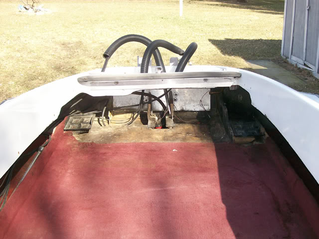

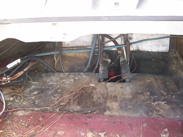

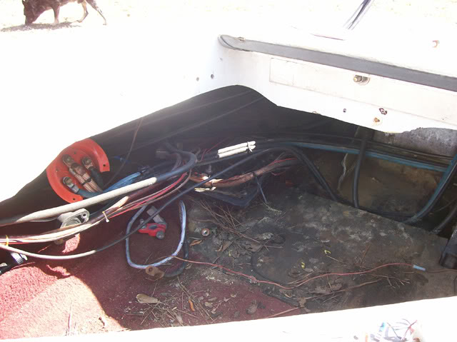

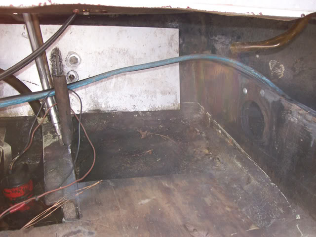

After about a few hours of work today I managed to get the back seat out and that thing was completely rotten. It was just sitting in there so that was super easy to get out. Just lift and toss.
Next I drained about 4-5 gallons of what looked and smelled like paint thinner out of the gas tank and that got that outta there.

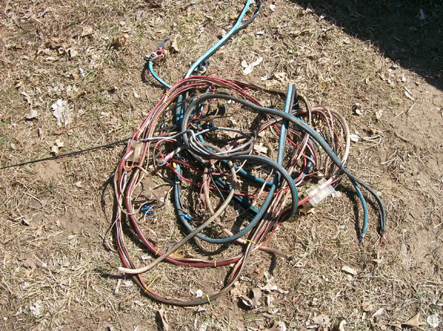

Next I started removing all the wiring and so far I am half way done with that. I will continue taking the rest out in the next day or so but got most of the big stuff out.
Well, here is what I started with.
All that wiring kind of scares me. Time for all new stuff!
Here is half of the wiring I pulled out of it. Alot more to go yet.
Here it is with the back seat and gas tank and all the wiring out and all cleaned up.
Dont worry, This winter the major makeover gets done. Just putting in the water this summer to get it out of my system.
Until next time...

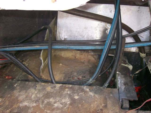

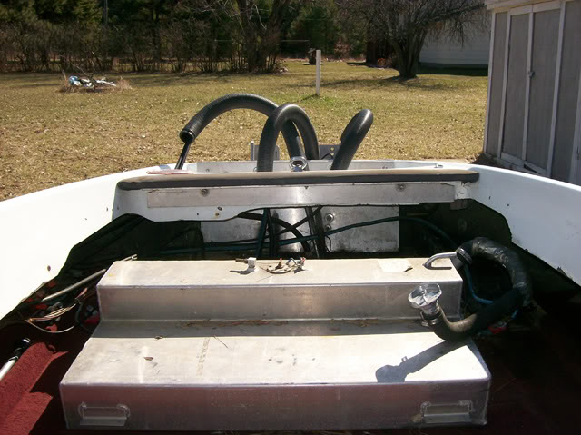

Worked on it a bit more today. Worked on more wiring. Got it all out of there for the most part. They sure didn't hold back on the electrical tape.

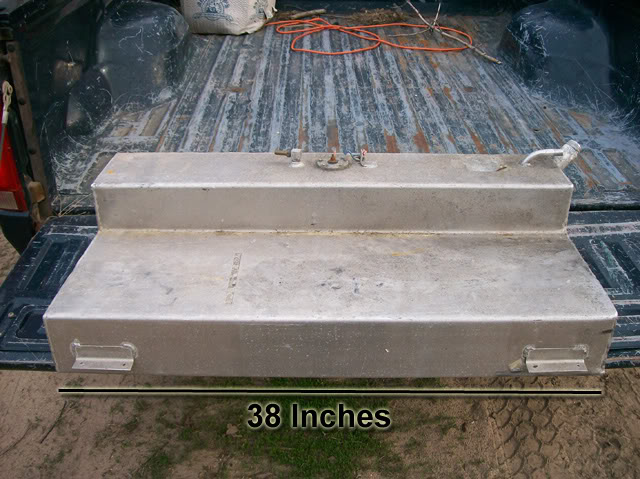

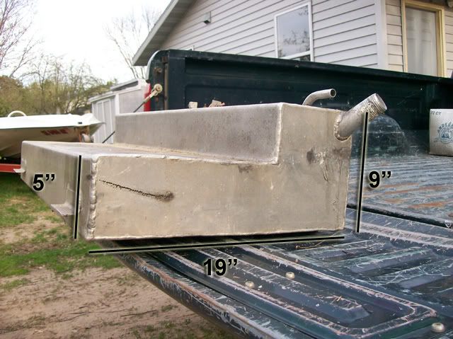

Here is the gas tank and wondering if there is any way to figure out short of dumping something in gallon by gallon to figure out what size tank this is off the measurements.
Also, Anyone know where to get a new sending unit for this? I am thinking of going with AutoMeter gauges. Wonder if they would have one that will work.
That black mark on the one side is a grease mark and its not a crack. Also, The little top section is 7 inches wide. I forgot to mark it in the picture.
77viper wrote:Most boat dealers should have a universal sending unit. You will have to bend the float arm to make it read correct.

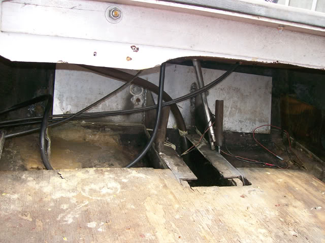

With the tank in the boat the filler neck on the tank is just about right under the filler on the boat.
As for the transom support inside, it does look like someone notched it so the tank would sit back farther.

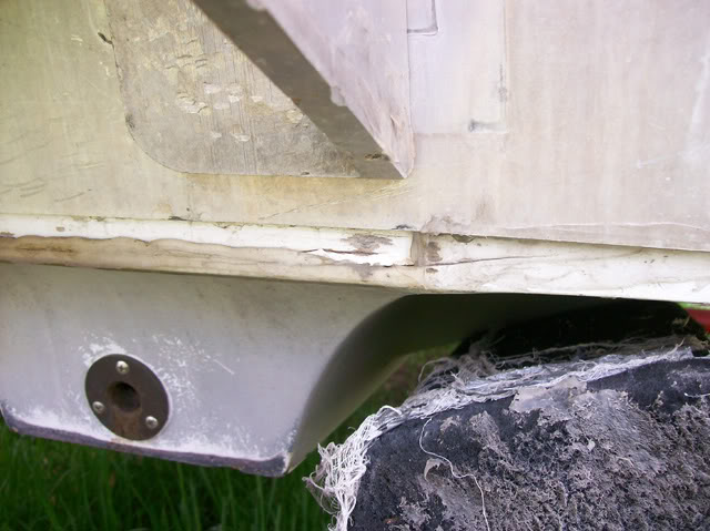

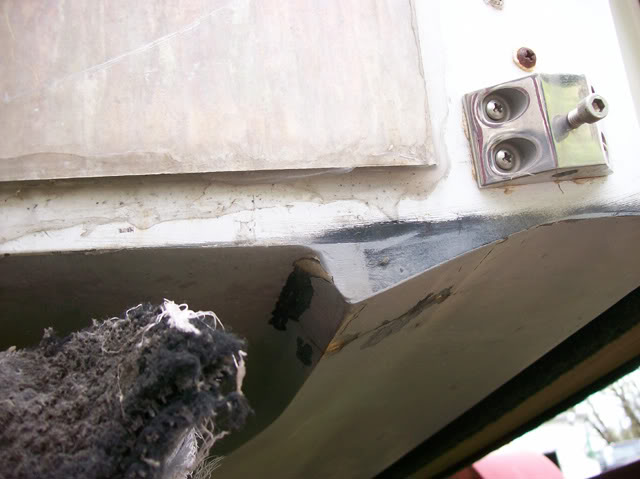

And now for the bad news of this whole thing but it has not stopped me from finishing this project, Just a little bit of a new direction now.
The neighbor guy came over today to check it out and while he was there we moved the boat around on the trailer so I could get a better look at things and I didnt like what I found.
Now I have not had the boat off the trailer myself so dont get on me to much about this.

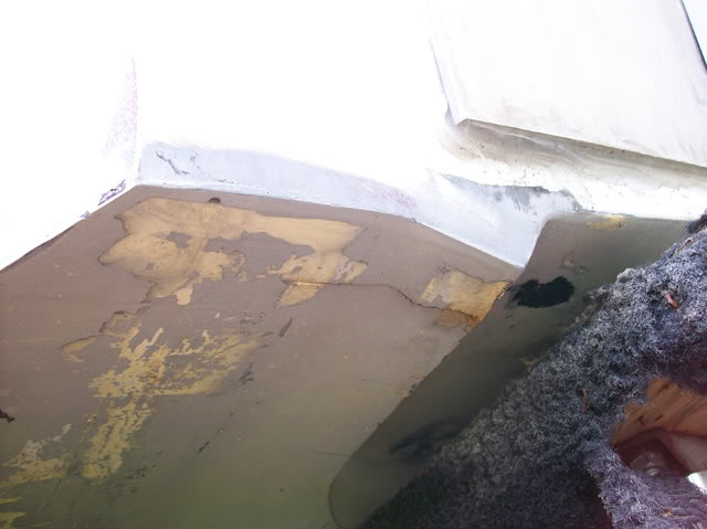

First I had been looking at some of this silicone on the bottom of the hull/transom area and decided to peal some off (Alot of it actually) and this is what I found under it.
After finding that is when I decided to enlist the neighbor to help me move this around some and look at this...
I really dont know what to say other than...

Well, I got a tiny bit done. Not near anything that should have been so far but this whole being sick and on all kinds of meds for 3 weeks now kicked my butt but I am now feeling up to working on the boat a bit now that I don't have to take them tasty non coated pills 3 times a day.
Today all I really managed to do was get the seats out and most of the carpet. The bottom cushions of the seat had wood bottoms and the wood was so wet it turned black. The back and seat base are all ABS though so I will be able to just get them redone at some point.
I also pulled all the carpet up and just scratched my head and said wow out loud to myself. lol
Here is the seats out and the carpet up. The back side of the seat box and the entire seat box sounds like just a hollow thin fiberglass box with no wood and it flexes like crazy in the back. Also not the lack of any glass/epoxy or anything on the floor. Only on the edges of the non marine grade plywood.
Notice the holes in the floor in the 2 pictures above and below. I am going to say 3-4 good whacks with the claw on the hammer to break the somewhat dry pot layer of wood then right into the mud! And that's just the floor.
Check out the lack of bonding on left side of the entire floor. I pealed a bunch of it up by hand. The right side was actually attached for the most part.
I would have been able to just pry the floor out I'm sure if it wasn't for the screws every 6 inches or so from the seat box area back. And as luck would have it they were all filled with glue or epoxy or whatever they used so they are all going to see the grinder.
Here are just a few more pictures I snapped today. Someone really took just about every shortcut on this thing at one time.
How do you like that fiberglass knee brace. If that's what it really is.
