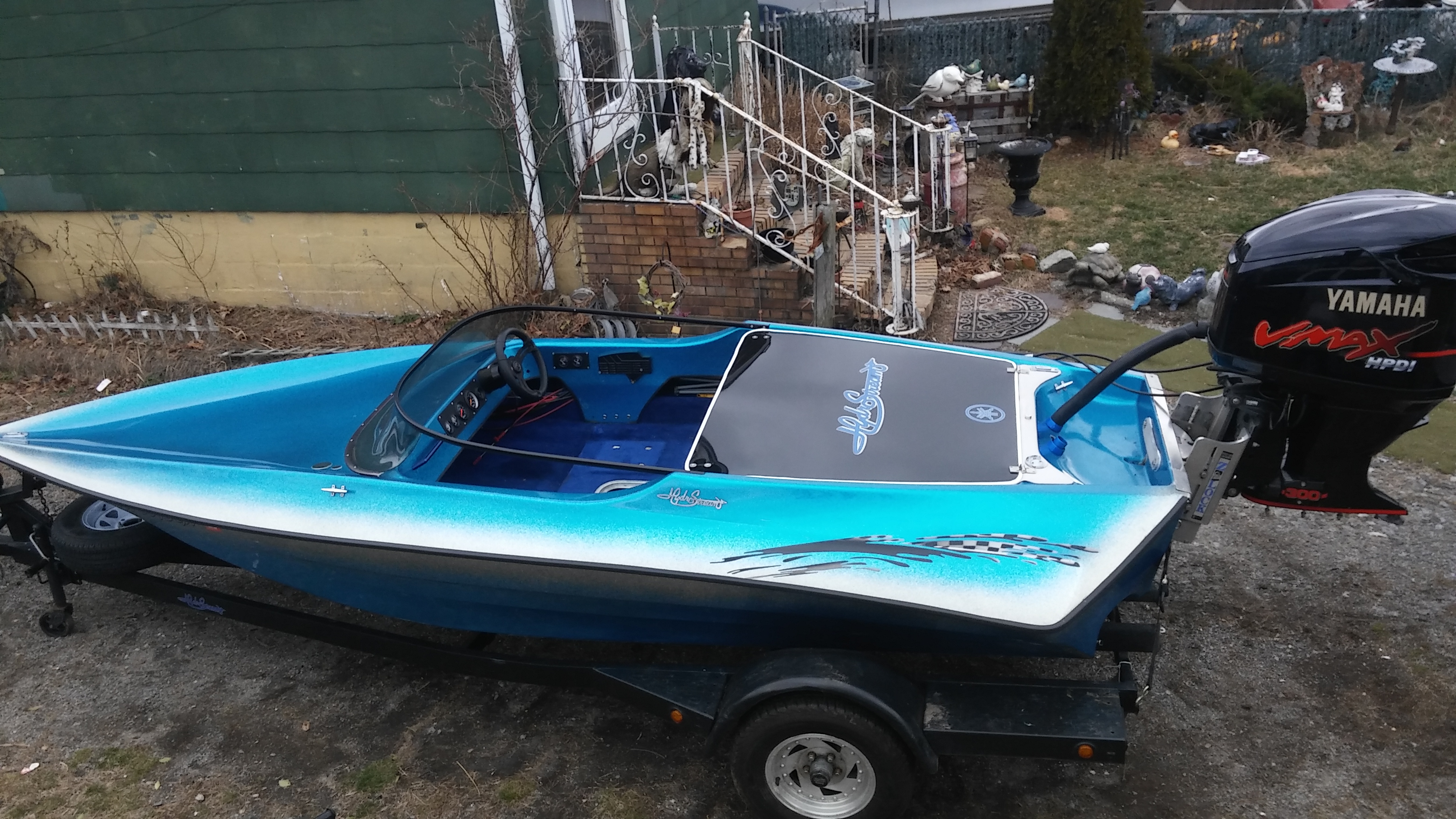

Just posting my setup for those interested.
89 vking yt
Blue white carbon interior
Right hand steering
2.4 uflex hydraulic steering helm
Marine machine side mount ram
3.3 300hp yamaha hpdi
8in setback
35p 4blade bravo
104mph at 6150rpm
New goal is near 110 at 6750rpm this season
